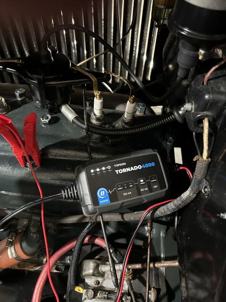

I have a positive ground with an alternator. Red to the head bolt, black to the starter wire and it shows reverse but when I go directly to battery red to negative and black to positive it shows fine. Not a big deal, but was thinking it would be easier to connect it the way Paul shows in the video and then I don't have to pull up the carpet and run wires under the door, etc.
Well that says alot about some of your past posts , cold not start , no start , ect ! Somehow somewhere the battery changed polarity ! Ignition coils work better providing better spark when they have proper polarity !
Just connect it at the battery. The battery doesn't care if the car is negative or positive ground. The red + and black - on the battery are always the same no matter what the car is.

??? You stated "red to negative and black to positive" which I was referring to and is incorrect.[/QUOT I disagree with you Y-Block. I hook them up all my cars at the starter with black to the starter cable and red to the headbolt. The cable on the starter goes directly to the neg pole on the battery and the positive pole on the battery goes to the chassis which is connected to the headbolt. It works for me on all 10 of my Model As.

Perhaps I misstated and apologize for doing so. As you can see from the attached pics I have a true positive ground system and I was able to get the charger working correctly connecting to the head bolt and starter apparently I just didn’t have a good connection on the head bolt.

??? You stated "red to negative and black to positive" which I was referring to and is incorrect.[/QUOT]
That is not what I said. In the normal world, Black is considered Negative and Red is considered Positive. Using a Red wire for the Negative cable just confuses things.

With the battery being under the floorboard on my A and 31Plymouth, I connected the battery tender clamps to the starter post and ground as suggested somewhere.
Does anyone else do this? Any problems with doing this?

Yes see my pic

The first picture in post #50 shows the red battery cable connected to the negative post of the battery. See the little negative mark on the battery? Where does the other end of this cable connect to? If it goes to "ground" on the frame, transmission or engine, then your car is negative ground. Also, the same picture shows what looks like the negative clamp from your battery "tender" connected to that same terminal.
