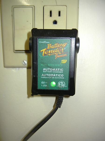

This is the one I use, see photo. It stays plugged in and connected to the battery when the car is not being driven for more than a few days. Does not overcharge and has the desulfator.

Why desulfator? When the lead-acid battery discharges the sulfuric acid combines with the lead plates to form lead sulfate. The acid becomes weaker. When the battery is charged the lead sulfate turns back into lead and the sulfur recombines with the acid. The acid becomes stronger.
If the battery sits in a partially discharged state the lead sulfate will crystalize. This crystal state of the lead sulfate will not allow the sulfur to recombine with the acid and effectively takes a portion of the lead plates out of action, reducing the capacity of the battery. If enough of the lead sulfate is in the crystal state the battery is no longer able to start the car.
The desulfator part of the battery maintainer sends a high frequency wave into the battery. This breaks down the crystals and turns them back into amorphous form that the battery can use. I really don't know how the high frequency waves change the crystals back to amorphous form, but it does.
A lead acid battery will self discharge a little at a time. So as the battery sits the lead sulfate crystals are being formed. The desulfator maintainer can recover the battery or keep this from happening by keeping the battery charged. It is very important not to overcharge the battery, so the maintainer senses the battery voltage and reduces the charging current when it is fully charged.
With regard to the Deltron Battery Tenders, the following is stated on their webpage:
"Battery Tender battery chargers do not include desulfation mode. Instead of stressing your battery to “fix” a problem after it develops, our smart chargers are designed to prevent sulfation from happening in the first place."

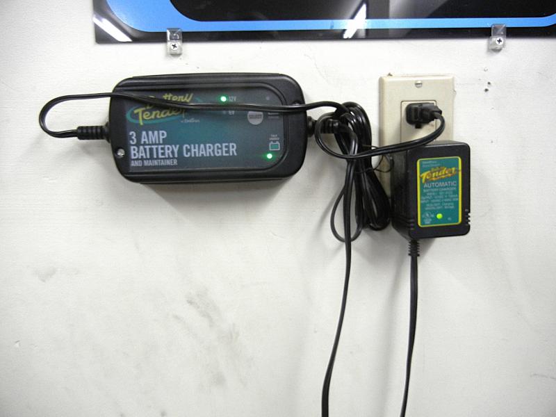

I have Battery Tender junior units that I have used for 20years. I have had Schumacher units that have typically lasted 5 years, but my current favorite is the NOCO is my current favorite.
My collection: for my 1970 Triumph Motorcycle, 53' Mercury, 70 Cougar and 2006 Mini Cooper. I also have one on my 2012 Jeep Grand Cherokee. I prefer the dual voltage when I can find them for a reasonable price.
All of mine are on24/7 and have been for 20 years.
