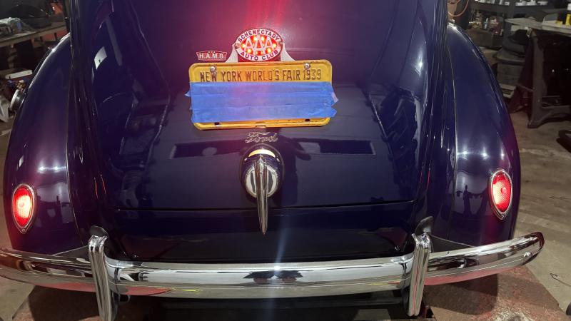

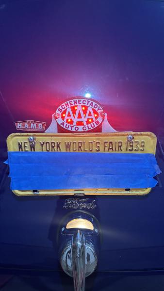

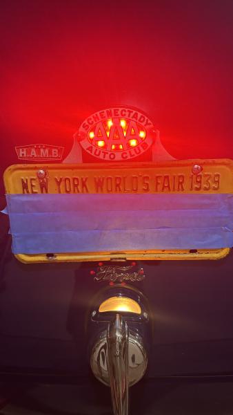

Old Porcelain Triple A plate topper , hanging on shop wall for long time.
Searched for an Oval , Tail Light / Brake Light to match.
3/4” thick chuck of Aluminum.
Friend took to work and used a Water 💦 Jet to cut curvature inside and out.
When traveling with other car guys, they love the signal it sends back to them.
Why do we need a 3rd brake light.
Because people are stupid and have to tail gate an old car / truck when in front of them.
