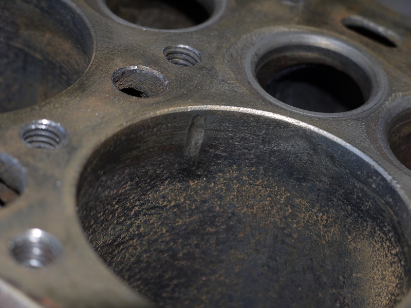

You guys already answered my questions about the pitted deck surface. What do you think about these two cylinders?

Not sure how deep those pits are, but those score marks look deep enough to warrant repair.
What's the current bore and what bore are you going to? You would have to measure the depth of the grooves and then double that. That would be the required overbore. And then determine if the block would take that overbore. If not, you would have to consider a sleeve.
If the grooves are .030 deep, it would require a min of .060 overbore to clean it up. And .040 deep then a .080 overbore, etc.

I would look in your area for a real good machine shop, maybe one that has access to a CNC mill, this is what we use here. On the CNC those bores can be "moved" slightly to actually require boring it only 1/2 the depth of that gouge, we just went through this very recently for a member up here. Am working on him now, his block had the exact issue as yours, a gouge most likely caused by a broken ring!
It can also be accomplished with a conventional boring bar setup but not as easy!
Thanks, Gary in N.Y.
P.S. The statement mentioned above about measuring the "depth" of the gouge is how it's done. You start at that point! It's also going to come down to how much oversize you want to bore it, the gouge depth MAY be moot point??
Sorry guys, I know you need more info. The best I can get in there and measure, the first pic is the deepest @ .025"-.030". The wider one is roughly .010" at deepest point. It is standard bore.
If I end up using this block I was considering going 3.312" bore. My truck is still running so maybe my current block is OK. I "MAY" have a crack in exhaust port. Slight dry trail down from cracked exhaust manifold. Condensation I hope. I won't know until I tear it down.
I was thinking as rusty as the bores are, the pistons were beat out of it. The wider gouge almost looks flame cut though.
That's kind of what happens with a broken ring. It always gouges where the combustion gasses go through. The broken ring pieces don't help any either. They can gouge out material too. If you wanted a big bore then it looks like you won't have to lose sleep about going way oversize since you already have a reason to. If you haven't yet, get the block checked for leaks and have them sonic test the cylinder walls to see how thick they still are. Don't need to spend good money after bad.

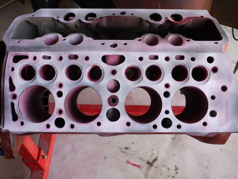

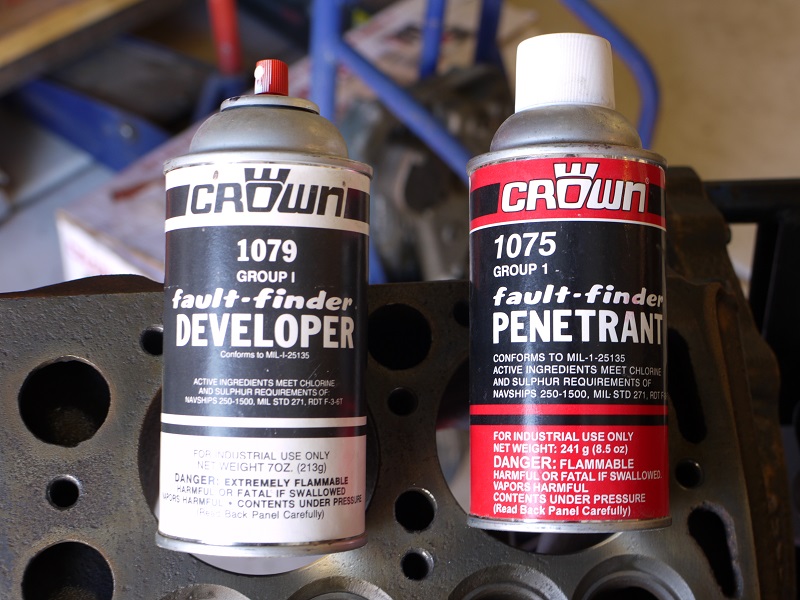

I haven't paid for this block yet. I have pressure checked it. I fabbed up block off plates and put tank valves on them. Pumped up with bike tire pump. I did it with water in jackets and with air alone. No leaks I could find. I dye checked for cracks. Found one tiny crack starting. Has not been to a machine shop yet.

I just included a couple images. I checked the entire engine. Nothing found at pan rails, cylinders, ports or anywhere cracks typically form.

If you're going to 3.312, those marks aren't going to be an issue. The little crack you showed is totally typical and of no worry at all. Some of us have seen cracks in that specific place so many times, that we claim Ford had a part number for it! LOL
