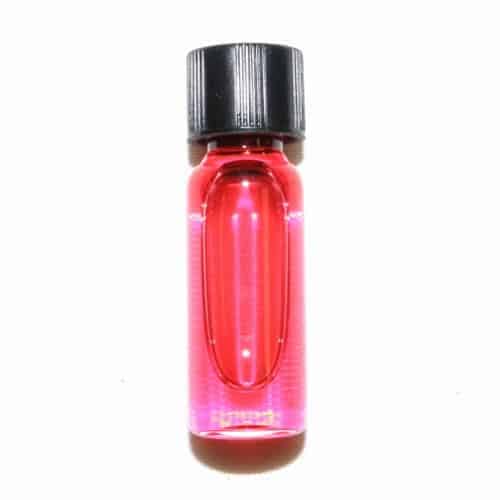

SEE> https://straight-eight.com/product/king-seeley-hobson-fuel-gauge-red-fluid/
King Seeley & Hobson Fuel Gauge Red Fluid
$35.00
77 in stock
SKU: J-5606-2-S8 Categories: Duesenberg Model J & SJ, Gauge Fluid, Gauges, Dash, Dash Trim, Instruments, Gauges, King Seeley & Hobson Fuel Gauge, King Seeley Fuel Gauge

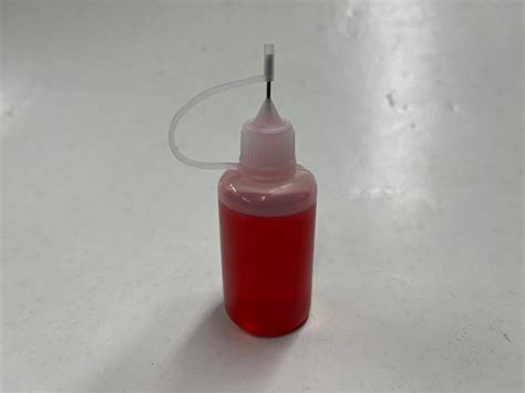

I bought the stuff from straight eight. It was in a very small bottle and faded. The stuff from Renner's is a much larger bottle and has a nice fitting to squeeze it into the gauge. I recommend Renner's.
SEE > https://rennerscorner.com/gauges.html
B-9280-F
Description: RED FUEL GAUGE FLUID
Comments: 1 ounce bottle - hydrostatic gauge
Application: 1932 - 35 passenger / commercial & 1936 heavy truck
$28.00
