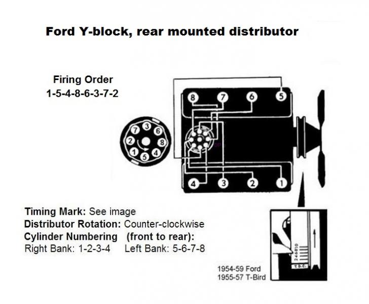

Depending on which style of crank pulley is on the engine, IF the weight ring has timing marks on it, the ring can easily slip out of position when the rubber layer fails.
