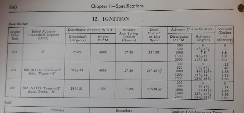

'54/'56 single canister Loadomatic distributors use metered(?) vacuum for All their timing advance functions but at a Much lower level. As shown in the far right-hand column in photo 2, more vacuum = more timing advance.
Effectively opposite the vacuum signal from a '57+ carb.
Fyi, these two conditions are why a '57+ carburetor cannot control a Loadomatic distributor correctly.
