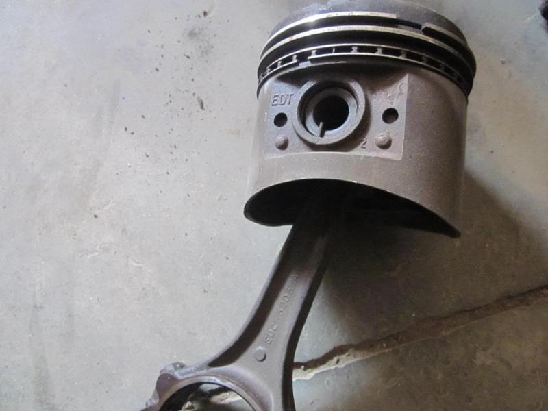

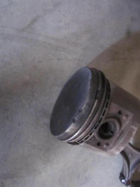

The MPC shows a dedicated piston (pop-up), it's only having been offered STD, no O/S which means to me (IMO) they were sourced outside.
Do you still have the original piston(s)? There was a manufacturer that could duplicate pistons, especially useful on the MEL Series.
EDIT-
Let me backup a bit... take-out piston shows flat ...
EDT Piston - EDC Rod
imageproxy.php
... back to the drawing board ... :rolleyes:

They are flat top, but have a different Service PN for whatever reason.
You missed my statement retraction earlier ... :D
