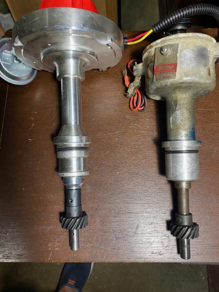

I have a 1973 302. I am upgrading it to a 4 bbl carb and a HEI Distributor.
Everything has gone smoothly until I dropped in the HEI Distributor. It does not sit flush on the block. It is maybe 3/16" up. The original sits flush. I did measurements with a caliper and ruler on the shafts of the old and new. The old shaft is about 1/16" longer then the new shaft. The shaft from the bottom of the helical gear is .04" longer on the new shaft then the new. I don't know if this is any critical difference or not. Yes/no?
I do see a difference if you look into the bottom of the shafts up. Both are hexagonal to fit over the oil pump shaft. The oil pump shaft is hexagonal with a pin on top. Hard to see but maybe the pin is 1/2' long. I do not understand it's function.
So I have not tried to turn over the engine with the starter. I could tighten down the new distributor with a longer bolt and turn over the engine but if it is not seated correctly I may snap something.
I am going to turn the engine back and forth a few degrees with a breaker bar. Maybe the new distributor will seat down all the way.
The new HEI is from Amazon and there is no name on it. I may return it and spend more money on a name brand with customer support.
Any help is greatly appreciated. Thanks

Possibly you are not engaging the oil pump drive shaft, that would prevent the distributor from seating down on the block. Don't force it! You have the right idea on returning it to Amazon.

Like others have said, it might not have dropped all the way down. That's pretty normal when you put a distributer in. You usually need to crank the engine until everything finally lines up like the oil pump. It will usually drop down into place while you're cranking it and putting a little pressure from your hand on it. Your distributer gear is already engaged at that point, so you don't need to worry about it, just getting the oil pump shaft to go into the bottom of the distributer. Unless that GM style distributor is too long. Compare the length from where it sits against the block to the end of it. Should be really close to the Mallory. You could also take an oil pump shaft and make sure it goes into the new distributer, but it probably does.
