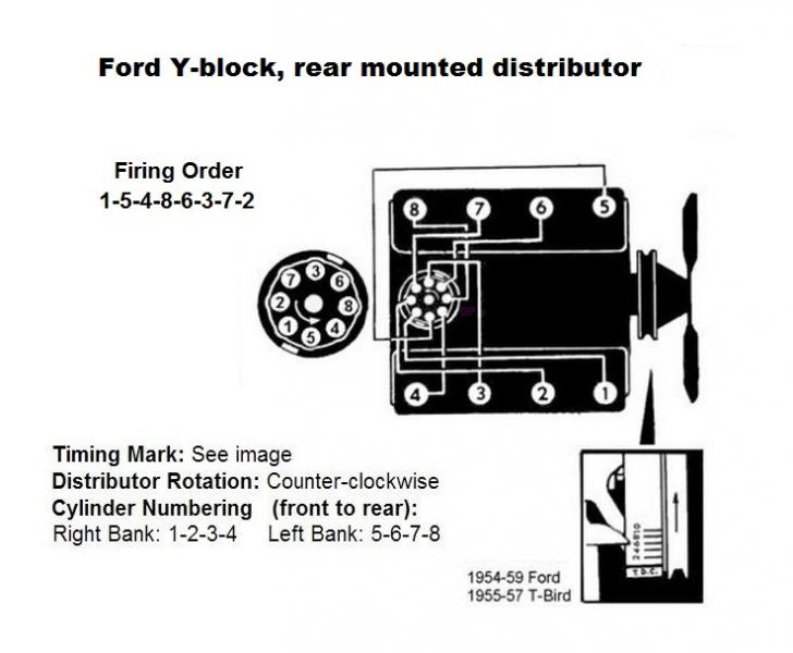

If you're leaning over the right side fender looking at the distributor & plug wires on top...
This diagram may help.
The image says '54 to '59 but it's good for any of the '54 to '64 Y-blocks. 239 to 312.

Looks like the diagram show 6 before
I am in the process of changing my ignition system. I just came in from making up, and putting labels on my spark plug wires.
