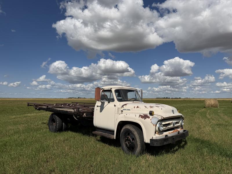

Honestly, I would buy a 40 ford first (maybe even your dad’s old car). It might come with a better engine than you are starting with and you can use your engine for parts.
I like watching the YouTube videos of the repairs in developing countries too but understand, they are making these repairs out of desperation because new parts are either not available or their time is less valuable than the parts would cost.
In North America, we can get parts for our old flatheads still. As mentioned above, shop costs are ~$200/ hr so we tend to replace instead of fixing.
Good luck with your project. I have had no problem finding good flatheads for under $1000 and you can buy an old low mileage grain truck for around $2000 around here.
