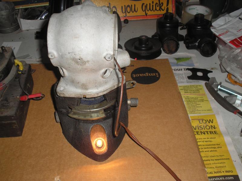

Hoop I think we are saying the same thing , I Use one above the center ,Taking the static mark as the reference you move advance plate up,As for 4 Degrees I think the 0 mark has the 4 Deg already built in so any advance from there would be deg per mark .= 6 Deg to the first mark (cam Deg ),I would have to verify this though ,I think you can take libertys with the adv plate up tp 3 notches and road test the car.below the center can give a loss of power and possable overheating.

Yes, moving the plate up advances the timing. But, what you and I call the center mark may or may not actually be 0 degrees. The point gap determines the accuracy of that center mark.
If you put the distributor on a Sun machine and move the index around, it'll give a 2 degree change per mark ... those are distributor degrees as I mentioned.
HOWEVER, as you know from messing around with your KRW and Wasco, the point gap (especially on the left side points) affects the initial timing. Change the point gap and the initial advance will change. This is why simply setting the distributor with feeler gauges and guessing at the index setting can be off a bit. Timing fixtures like yours take that into account and verify the settings.
It all makes for a great discussion that we all can learn from. For example, I mentioned chalk marks on the pulley and someone called that half-assed ... it does give folks another perspective into what's really happening. Who cares where TDC is if you are trying to determine the advance range. Similarly, if you want to locate TDC, you can set up your distributor on a KRW/Wasco, and it will indicate TDC ... for sure, 4 degrees BTDC ... for you.
