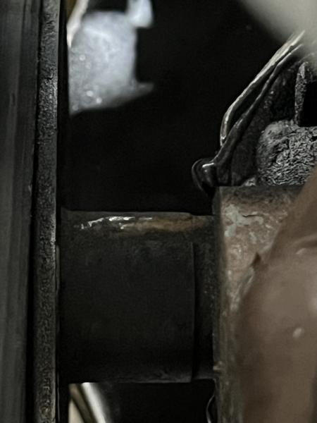

Brass 4 core radiator. The fan is almost touching the radiator an inch or less. Thermostats were not tested but with the coolant in that upper tank reaching 215 thermostats may have failed open at this point.
I wish I could put shrouds on but that isn’t an option for this car.

4 core brass radiator, fan is about just less than an inch of the radiator, new thermostats weren’t tested before install.
I wish I could install shrouds on this car but that wouldn’t be true to what it was.

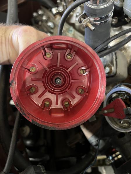

After looking at the enlarged pictures, I can't really tell what distributor is installed. It looks like a stocker to me (it's not a Mallory, MSD, Accel, or even a converted SBC). There is no vacuum line attached to it. so it could be there is no advance whatsoever (which would explain the 10 BTDC advance as a compromise). We need more information on the ignition to really help.

I know it must be an issue of perspective, but what is this? Something looks off.

I see you have posted pictures in an album including a few where you were cleaning the cooling passages. I don't recognize the distributor, but maybe someone else on here will.

It's been so long since I ran a stock distributor that I have literally forgotten what they look like, but I think that is a stock unit (the exterior mounted condenser does give me pause). The stock distributors are vacuum advance ONLY. The engine won't run correctly without the proper vacuum signal from the proper carb. All the rest of this is moot until we learn more about the distributor. I you want to keep the 97's you will have to run a mechanical advance distributor (these days, either an old Mallory dual-point or a converted SBC unit).

I don’t think the distributor is stock but might be a Mallory that was paired with the coil.
