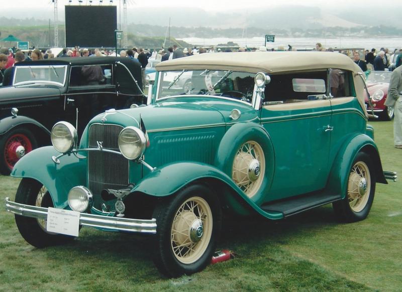

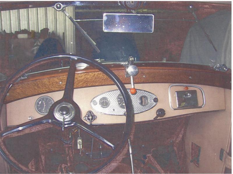

Dual wipers on our 32, and the accompanying picture, though grainy, shows the mounting of both the motor and the attaching post mounts.
