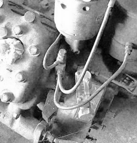

Harold, To me you have a 4.2 litre French Marmon engine. Those are like the 8BA but with the 59A style bellhousing.So your flywheel may be different than a 59A.I don't know.You might have to install a sleeve that slips over the collar that the release bearing holder slides on to stop the pedal from retracting to far.I had to do that on a T5 that I installed in my 36 Ford years ago.Here are pics plus one of yours that I edited as its to dark.
No, I have a 3.9 from a Simca Cargo.
The flywheel is the same as a 59a.
actually i´d say it´s a 3.9 Cargo.
the Marmons had other embossed writings on the bellhousing and a pad to mount the rebuild plaque. plus i have never seen the writing on the back of the engine center part above the bell housing. this is where the marmon had it´s oil filter and more like Cargo or even early Simca.
but i may be wrong.
Harold: Why didn´t you stick with the 11"clutch? i run a 4.2 marmon with 11"clutch and 39 trans (78case) with no issue .
