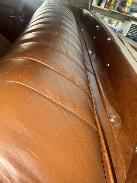

Hello, can anyone post a few pictures of the package tray are on a 1931 deluxe roadster? Currently working on this area, redoing and older restoration. Think I am missing a windlace piece that goes between top of seat and tray .Also seen fasteners for top boot? In this area. Thank you.

Hello, thank you for the reply, did check on B Tarrys website and some pictures were helpful. Vol 6 of how to restore your Model A has a lot of info , if I could find my issue.Snap fasteners on inside must be for top boot,

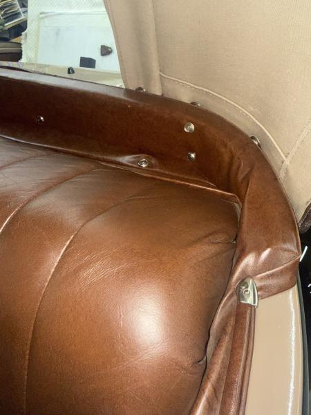

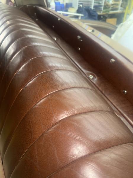

This is the package tray done by LeBaron Bonney on my 31.

Hello, thank you for the pictures, I assume interior in my car is a Lebaron Bonnie also I see now that a flap of material they had tacked to back of wood seat frame should cover the flat part of the package tray, also screws go through the bottom of package tray to hold angle on back of seat . What I also thought was a piece of windlass is actually part of the back upholstery. Thanks again, might get this thing done before summer is over.
