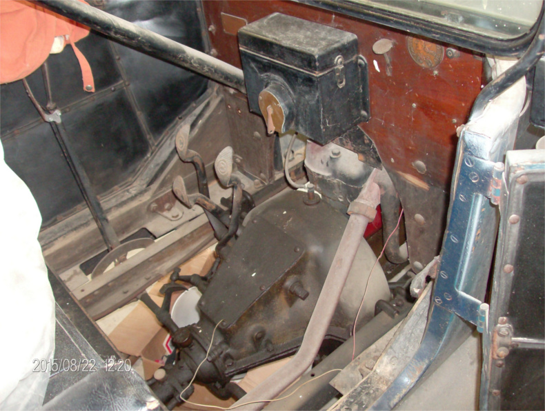

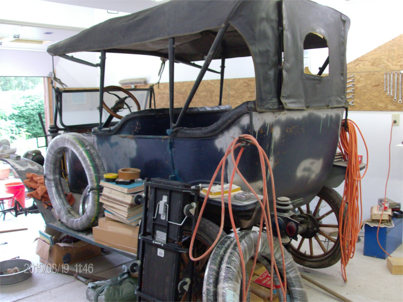

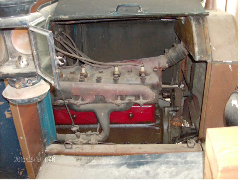

One obvious change is a later front axle. The '14 wishbone was mounted above the axle not below. All else seems correct for a 1914 from what I can see. Looks like a fun car to have.
Looks like a great car. For the right price it might be a great car to own. I think $10,000 would be the upper limit if the wood in the body is all good and there is no rust out in the metal panels.
Look at the wood under the front seat cushion. There will be a date stamp of when the body was built. The engine was serialized in late September 1913 so I would expect the body date to be a week or two earlier. The date will be in the form of a month and year.

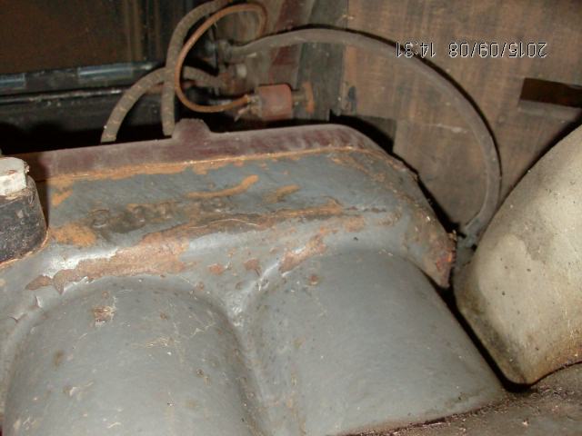

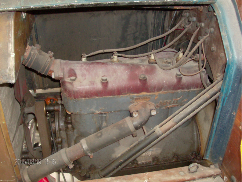

IMHO... it looks like a later 4 dip pan, and also SCRUTINIZE the lower water jacket corner on the inlet side. Looks kinda crusty and may be rusted through... ws

So you're saying the oil pan may not be the one that came with this engine? What's the significance of a 4 dip pan? Did it address a lubricating problem of the earlier models?

Could you be more specific? If you're talking about the white substance on the lower right hand corner of the radiator, there's some cotton-like fiber under the bottom fin there. I don't know why. That doesn't seem like a plausible temporary leak fix, does it?
Sorry about the obfuscation. Look at the inspection cover on the oil pan. The early long snout pans had a 3 rod dip pattern with the 4th rod dip on the main oilpan itself. Made adjusting #4 rod and rear main a daunting task. The later style inspection cover had all 4 dips which helped make rod adjusting a simpler task. At 100 years old, whos to say some one didn't take a later pan and change the snout and oil dam. If the angle of the picture was a bit lower, it would be obvious.
The second comment was regarding the water passage erosion/corrosion. On the drivers side of the block where the lower radiator hose attaches to the water jacket, it appears that the paint is showing corrosion bleeding from underneath, POSSIBLY indicating a crack that is leaking. The 1926 & 27 blocks were being cast a bit thinner up there and they tended to rust through faster. Again, with 100 years of well water cooling the engine, anything is possible, up to and including a freezing crack. If in doubt, clean with a wire toothbrush and check with a flashlight and mirror, or just fill it with water. ws
Look at the inspection cover on the oil pan. The early long snout pans had a 3 rod dip pattern with the 4th rod dip on the main oil pan itself.

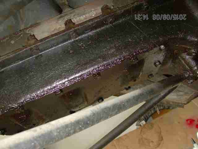

Hi Bill - I took a trip under my car today and brought the camera with me. Yeah, that's what I got. Here's a better picture.
Good catch. Under the lip just south of the block date stamp is a crack about 3" long. Can you make it out at the end of the putty knife? It's not noticeable looking down into the engine compartment through the open hood. You have to get under the car. I only drove the car once 40 years ago when I bought it and the previous owner started it for me a couple times but apparently, we didn't operate it long enough to get it hot enough to cause a geyser. It's been stored ever since with no coolant in it. I was just starting out in the Navy at the time of the purchase and the intent has always been a retirement project for me.
