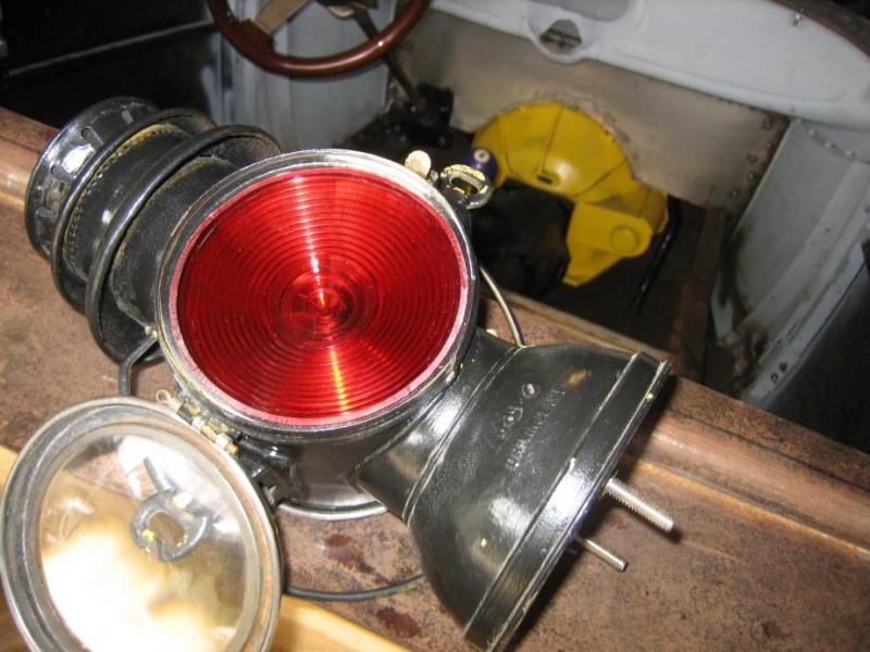

My tail lights I had got from my grandads barn. Here's the rebuilt with another set of 12volt sockets from the parts out of new trailer lite set from HF @ $9.99 ,parts put into my old 1900's lites. I'll need to redo my old paint to get these lites back up to highgloss,but had to get them working again first. In the late 1950's I had used some sockets from a junked car,but they are really junk now so put these new in. Plus used the trailer lenz so I could have bigger side to rear vs smaller red glass side of these cool old RAYO drivinglamps

Just for a compair of tail lights,big side vs smaller side of red lenz. On todays roads and all the cars,I'm going for the bigger light this time.
