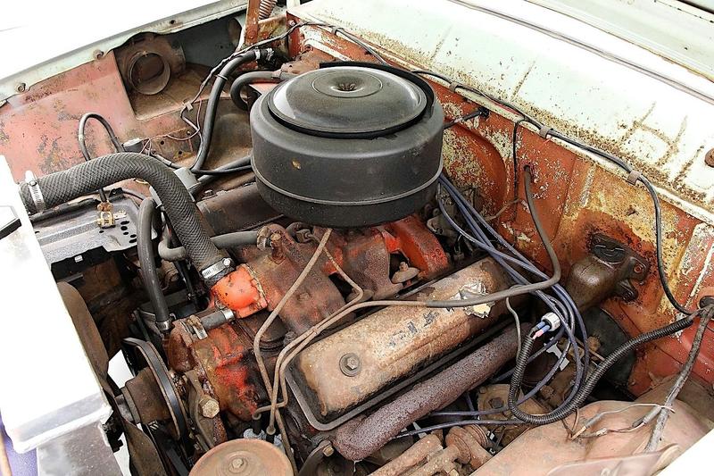

After a long internet search, I did come across this original engine bay that had a good enough picture to show that it does not have the scallop.
I think, but I’m not sure, the “scallop” is the bird manifold for clearance. Too many years with headers to remember for sure.
While the scallop may be for steering column or shift linkage(?) clearance in some full-sized vehicles it isn't a part for stock '55/'57 T-birds.
With larger exhaust port sizes starting in '57 the parts designers at Ford may have felt the need for a little more clearance and added the scallop.
The left side T-bird exhaust manifold has a different shape above cyl #8 and a different casting number. ECJ-A for '55/'56 and ECJ-C for '57
With the ECJ-C version having larger ports and the later style flat top.
A left side full-sized-car style exhaust manifold will interfere with the steering column in a '55/'57
T-bird. Their outlet flange is also rotated 90 degrees.
