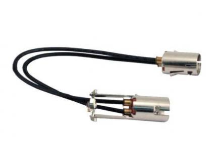

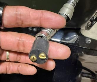

UPDATE: I discovered the culprit was the headlight socket. I went ahead and replaced it (thank you Snyder's) and I also went with this style of plug to keep the connectors in place. Success! Both lights are working perfectly!
