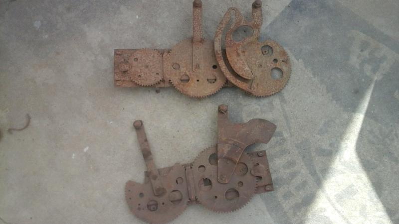

Saltydawg56 Junior Member Feb 21, 2018 #1 Anyone tell me which regulator is for front doors and which is for back windows on my 36 sedan? Attachments regulators.jpg 38.1 KB · Views: 39
R Royal Ryser Well-known member Feb 21, 2018 #2 I believe the top photo is a rear regulator and the bottom one for the front. Others will correct or confirm this.

40cpe Well-known member Feb 21, 2018 #3 I'm not familiar with the '36 specifically, but the top regulator has the pull-back feature of the front windows of my '38.

Saltydawg56 Junior Member Feb 21, 2018 #4 The 36 has the pull back feature as well, so the one on top in the picture is for the front door correct?

Barn Junk Well-known member Feb 21, 2018 #5 Should be easy!! The top reg. has 8 mounting screws for the front door (late design). The bottom regulator has 6 mounting screws for rear side windows. If your door has 6 mounting screws, it is a early design and you have the wrong door regulator.
