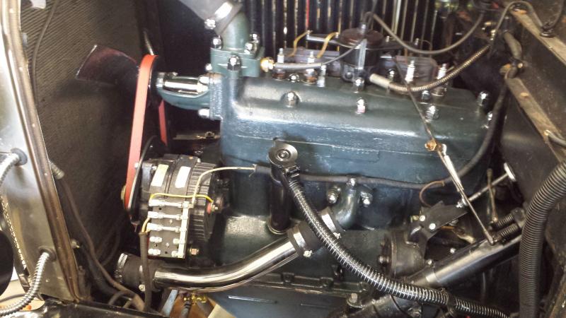

James A... One more option that's out there
That is great how the sensor goes up under the hood and must be almost unnoticeable. I'm going to put in one that mounts on the goose neck and the sensor line is visible along the side of the head which will not look so "hot" (ouch, how corny).
