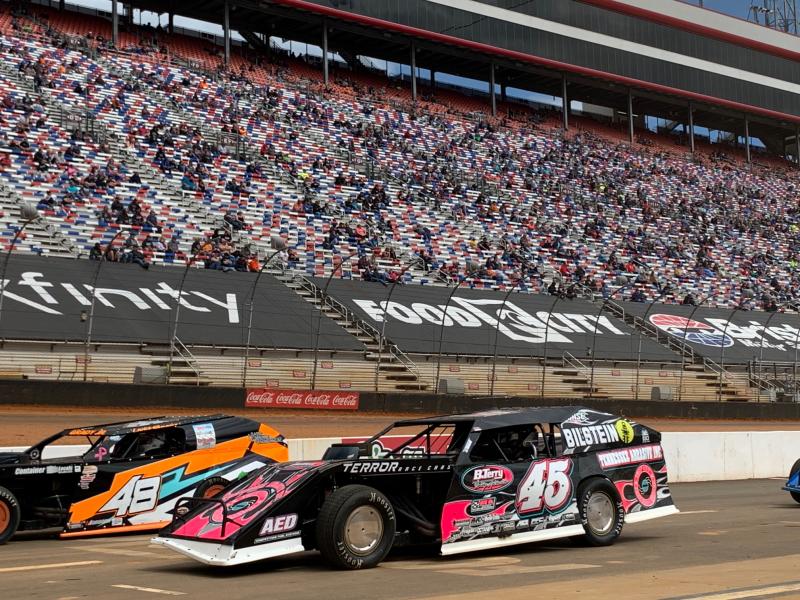

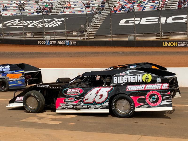

We use wraps on our race cars due to costs compared to painting for visual appeal. We pay about $8.00 a square foot for the vinyl plus the graphic design work (-not applicable on most Model-A jobs). We do our own vinyl installation in-house which saves costs too (...at least it does after you become proficient with installing it :D ). If I were building a Model-A that would be used for motorsports (Bonneville or Hill Climbing or ??) I would definitely consider vinyl just for visual appeal.
You are partially correct in the underlying surface must be in great shape however this really needs to be emphasized as it is much more critical than most likely realize. The costs in a quality paint job is having a smooth surface for the top coat (-or vinyl) to adhere to. A dent, or paint chip, -or even 'orange-peel' paint quality will show thru on a vinyl job. Therefore the costs associated with a good paint job is the costs of prepping the foundation (sheetmetal repair and primer/surfacers) to remove any and all imperfections. If you are going to go thru all of the effort/expense to have a quality substrate, then you might as well just use paint IMO.
I believe Bob Campbell has a picture of his Model-A on his trailer that looks really nice.
Maybe he will post a picture of it?? Below is a picture of our 2022 race car that we debuted this past weekend at 411 Speedway in Tennessee.

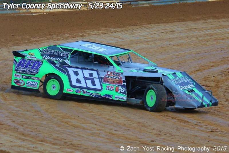

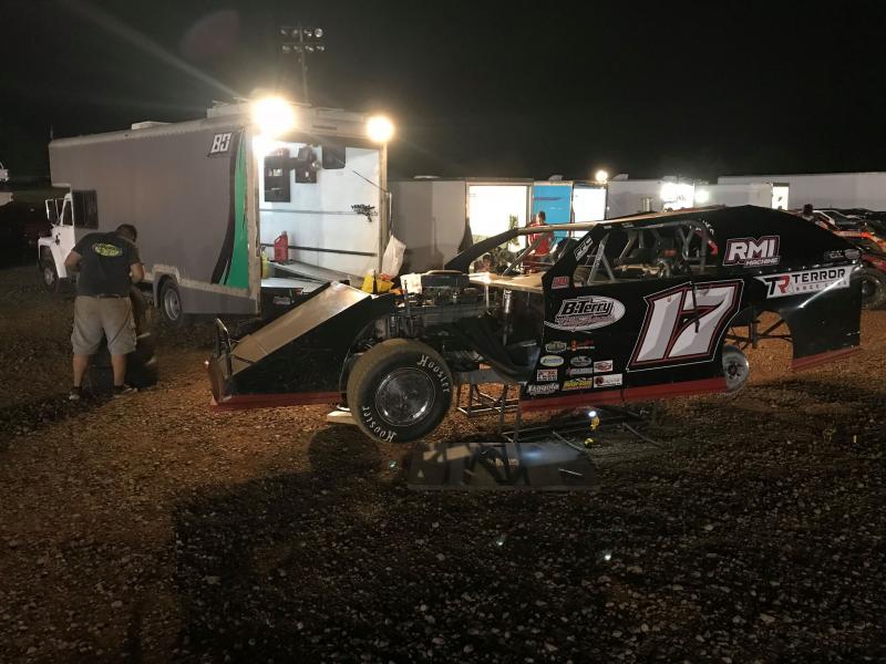

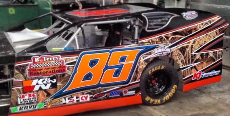

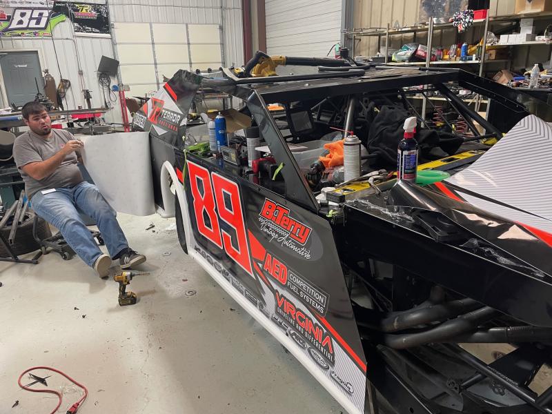

...a few more. Same basic aluminum body panels but totally different look that is easily changeable.
