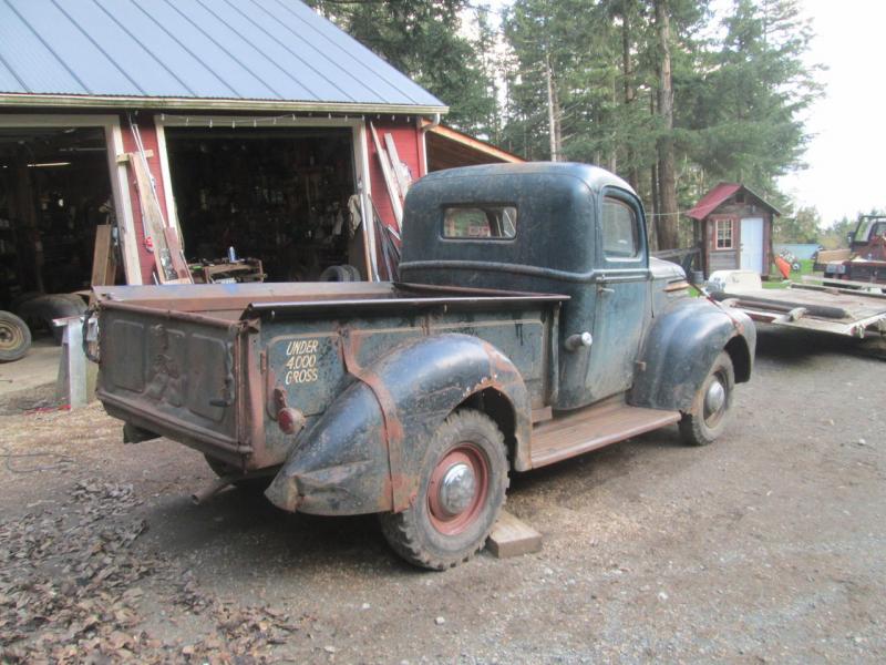

Thanks guys. This has been helpful. Last Friday I brought home a '47 tonner rolling chassis. It would make a cool HD woody, but really think the 1/2 ton would be more user friendly when finished. Besides, then I could use that nice cab on the tonner frame.

Once again, good info. I haven't ventured into the world of facebook yet. I'm holding off as long as I can. I have a lot of jailbar parts and 3 59ab flatheads. I kind of hate to sacrifice the complete pickup in the earlier post, but it has a good title and box floor, fenders and tailgate are pretty bad. The cab I'm looking at to cut is on a 1 1/2 ton truck with no bed or engine. Seems a good candidate because the door bottoms are rusty and so are the floors. No title.

Flat looks great on that curvaceous front end.... Why wouldn't it look great on a jailbar truck? My wife just gave me the green light on heading to Eastern Washington after work on Thursday to pick up the cab and front clip there. The cab would be cut down for the woody and the front clip since it has the larger fender openings would go on the tonner chassis I just bought. The half ton jailbar has two other sets of front fenders in the bed, and a NOS set of jailbars I have been hanging onto because they are too good for most of the wrecks I bomb around the island in.
