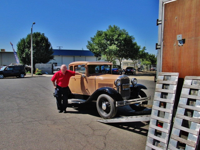

On a Model T or Model A:
(2) from the rear axle to the rear using ratcheting nylon straps - not chains
(2) from the front axle to the front in the same manner
190014
I have safely transported well over (100) Model A and T vehicles
in this manner ..... :cool:
Including this 1930 Model A I dropped off to Bill in Visalia, CA
on Friday that came from Leslie & her Dad in Ft. Bragg, CA
190016
Jim

When you cross tie the rear, what keeps the strap close to the wheel? Does the taper of the axle housing keep it in place?
