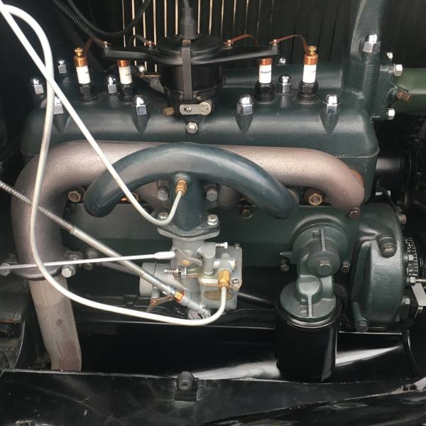

Slip Plate is great stuff. I even use it of my exhaust manifold. Prevents rust.
