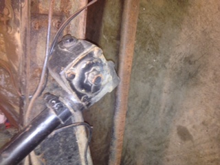

32Gnu Senior Member Aug 14, 2014 #1 Can someone help me ID this steering box? Its on my 34 P/U project.. but I know its not the genny.. Thanks in advance.. Attachments 34 pb.JPG 38.4 KB · Views: 74
NealinCA Well-known member Aug 14, 2014 #2 It's a Gemmer III box and looks like a 48-52 Ford F1 pickup box...but the frame mounting flange looks like a 4 bolt rectangular pattern, rather than a 3-bolt triangle. Has the flange been modified? Neal

32Gnu Senior Member Aug 15, 2014 #3 Yes Neal.. About everything on this truck chassis has been modified, most not for the better! If the box is good that's good news..
