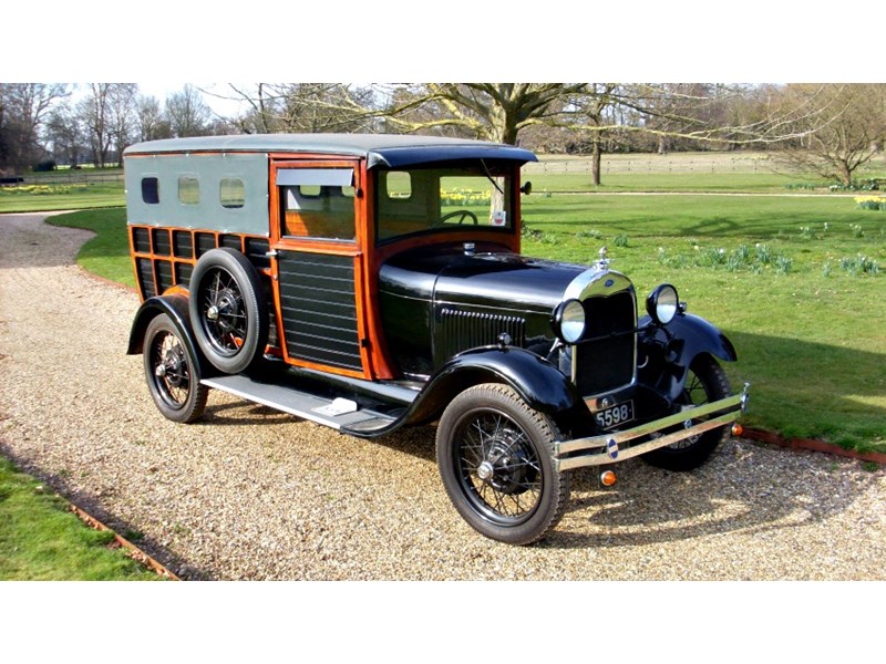

UKWOODY,
Does your name mean you are in the UK? If so, is your car RHD? If so, it is entirely possible that the advance lever does work the other way around.
On RHD cars, there is a bell crank mounted on a boss cast into the inlet manifold. If you connect the rods the wrong way 'round, advance is up and because one arm is longer than the other, you can't get full advance.
Here is woodies car L/HD
