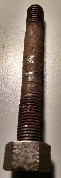

take old head bolt and nut thread half way on and it will bolt on to pump shaft fine threads holding fan hit with a good blow of hammer it will come off!
