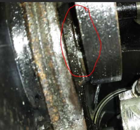

In the picture posted the rear seal is not visible, but it does look like some of the front thrust flange is missing on the rear main cap.
A stock A engine doesn't have a "rear seal" as we think of one today, it just had a slinger and grooves with a drain on the bottom, but there are many different methods that have some kind of aftermarket "seal" that has been tried as an "improvement" or repair instead of fixing the root cause of leaks.
Without having more than a picture to go on the #4 rod looks to of had a bonding failure of the tinning to the babbitt.
The next step is to take the rear main cap off to look there at the "seal" area, and the babbitt
Thanks

If everything else is sound with the engine, a new babbit job is not that terribly expensive. I fear if one part of your babbit system is failing, it is time to redo the whole thing. Most likely, anyway. Send it to James Rogers.....

First, the rod oil grooves are wrong, but workable, but the reliefs at the parting line are all wrong from what I can tell. It also looks like in the photos that there is "gouging" of the babbitt from "foreign material", ie, hard sediment. Get an oil filter. Is the crankshaft scored too? And the babbitt looks thin. Herm Kohnke can analyze this best if he is still reading this forum. Have not heard from him in awhile and I miss his contributions.
A "mere" chip in the thrust face babbitt can be tolerated without repair, so long as there is no separation from the underlying cast iron, but since the rods were done wrong I expect the mains were done wrong too. I suggest you get a new babbitt job from someone who knows what they are doing. Ask questions. Search forums on this issue on this forum to learn about babbitt jobs.

No way to tell about the mains without inspecting them, but with the chip off now, and the apparent chip on the rod looking like a bonding failure as noted by Kurt in NJ, I would not trust it.
