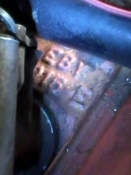

The block & heads that were in the car (photos 1 & 2) gave the initial impression of being correct for the year '55 (freeze/core plugs in the ends of the heads) even tho the intake manifold and distributor were both '57 versions, a common upgrade.
But the EBY ('54 Merc 256) casting number on the block and heads was a dead giveaway (photos #3 & 4) along with 272/312 spark plugs not fitting in the heads.
