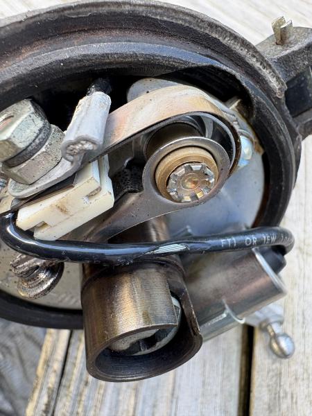

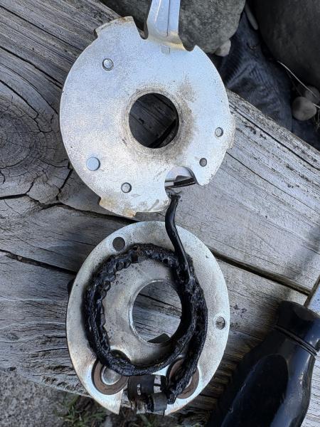

Got it apart,so that’s where all that smoke was coming from! I think what happened was the wire lead between plates was cut into by spring. Wire is still bare on condenser lead though.

Here's an important note: I just changed my condenser ... my rotor hit the wire and mine only started missing not burned up. In looking at the situation I realized the "new one" from NAPA had a much shorter wire than the one I replaced and the next one from Snyders. I think we need to buy our stuff from Model A suppliers!
Your second shows exactly the problem The NAPA condenser makes the wire ride up...the Snyder's one is longer and lays in the cup of the distributor...where it belongs!
