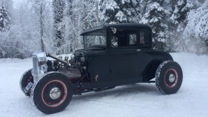

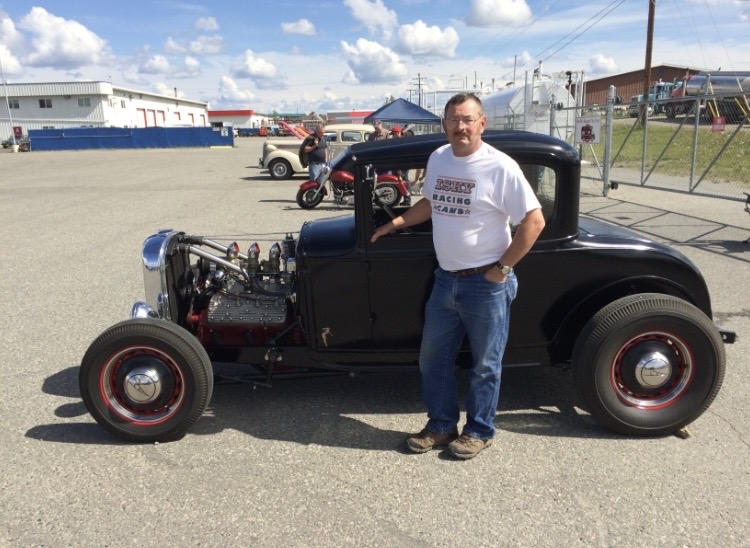

I am 6 feet
When I built my hot rod I was considering chopping the top couple inches. I’m so glad I didn’t. Even with the standard top it’s a tight fit.
