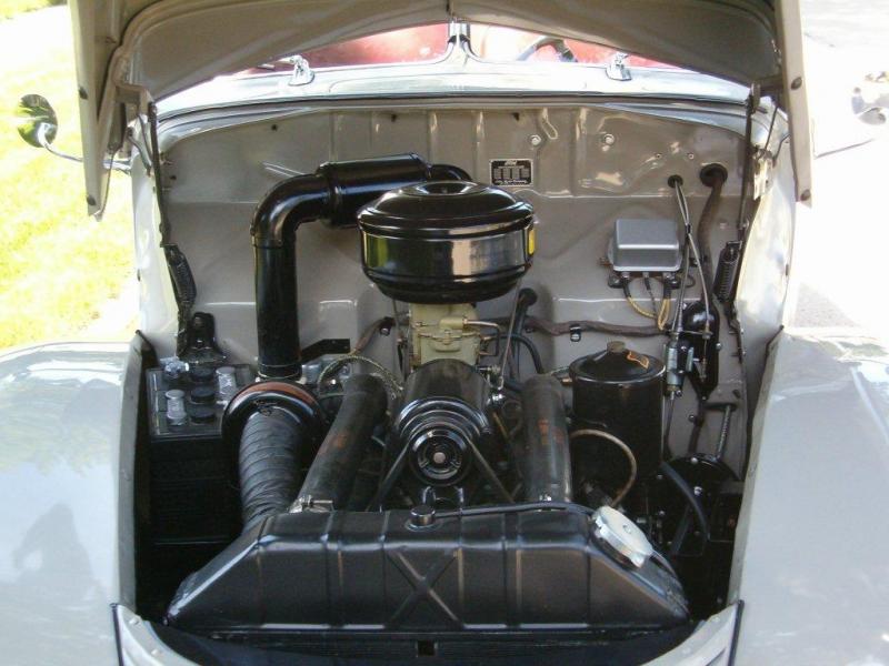

Hey all, does anywhere sell a correct longer 1940 Ford negative battery cable for a proper terminal 5v battery so the cable goes around the hot air tubes to the solenoid? I realized the one I have from CWMoss (their only 1940 neg battery cable) is too short.
This sort one probably works for a 12v battery, one without the hot air system, or the modern 5v batteries with the reverse terminals.

I think the biggest issue is trying to figure out the length it should be. The standard is 13 and 1/4 inches according to Kube's book, and that's the size of the standard negative cable for sale everywhere. But it's too short for the deluxe with the hot air tubes.
My '40 is in parts right now, so I can't measure the distance it needs to be.
The same cable was utilized regardless of whether or not there was a heater. There's a different issue going on here. Photos may help us help you.
