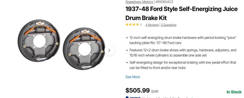

Thanks to 38 Coupe for clarifying the basis behind the different braking systems. So, for stock 39-41 brakes, it appears that I will have to stick with the stepped Lockheed parts, unless there is a way to retrofit the 39-41 backing plates to accept the Bendix system.
Brian Bass converted Lockheed plates to Bendix style, both front & rear; not sure where his program stands currently.
Speedway Motors does their own version, all new stuff. Fronts only. Unknown how they work.
It isn't really all that complicated to rework Lockheed plates to Bendix. I built up several sets when I was doing brakes.
