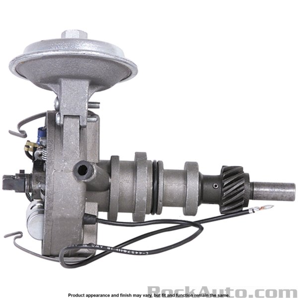

Thanks for the update and stay well! I have a small six Loadamatic I want to get converted to mechanical advance and Pertronix so I'll try him!
I cant do it but i can help ... Get friendly with the auto zone guy or rock auto is you are a computer guy. Buy a complete distributor from a 1962 Ford Falcon ( this gives you correct rotation and mechanical advance. Take it apart by removing the drive gear and shaft do the same to your loadamatic.....
take all the parts to a machine shop and say i want this drive gear and lower housing mated to this falcon unit ....they should be able to do that ????
