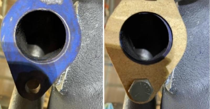

When you take your Model A manifold to most machine shops and tell them you want the center hole opened up they're going to indicate and line up on the center hole. You'll see in the pictures below that the center hole is a cast hole and is never in line with the bolt holes because of core float / shift. This is why extrude Home and media honing wouldn't really work because it's going to follow the hole that is already there and he will still end up with a step on one side. You must use a gasket lined up on the bowl holes and trace the new center hole onto the manifold flange. Doing this will correct misalignment it's called port matching. Often you will be taking more off of one side than the other, this is actually truing up the center hole to the bolt holes, which are the same as the carburetor bolt holes and throat. I recommend only chamfering a short distance because I've seen and have had people telling of manifold flanges breaking off because people made the walls too thin. And like I said, you get most of the improvement by getting rid of the step which causes circular turbulence this is air not moving forward but going in a circle around that step in diameter.

I made up a fixture to hold the manifold at the proper angle to bore it. I use a carbide
bit on a 8" shaft to round the corners at the top of the manifold.

Mike if you don't have time and a little extra money, Snyder's is selling an A intake bored out. It was around $100.00 and is brand new. We've drilled out a number of them following the info from Dave Renner.
Hi Mike, when I was still working, I had the foreman in the machine shop bore out 3 intake manifolds, got 2 back. the first attempt he bored through the side! The second two he lined up with the bore and not the flange. I feel it makes a difference. Like the post above, you have options buy or machine.
