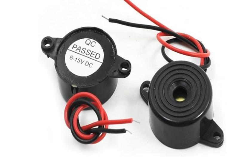

Snyders carries 6-volt beepers. There loud and I took a piece of sponge and taped it to the beeper for just right loudness that I wanted.
I used one of those also, I wrapped black electrical tape around it until I got the volume I needed, just enough to hear it above the Red’s headers.

^^X2. This is the same style I installed in the Model A with just enough tape to reduce volume to suit.
yep! that's the same buzzer i bought!
i plan on installing a female spade connector to the "P" terminal on the flasher that will have two male spade connectors on it. IOW a splitter. so that i can drive the buzzer with flashing current from the flasher's "P" terminal that powers the flashing bulb on the stalk. and because most of the piezo solid state buzzers i have seen have a black and a red pigtail, and assuming that the black one is meant to be connected to ground, i will have to connect the red one to ground on my positively grounded ford. and the black one to the splitter.
does that sound reasonable?
Correct! If you are running 6 volt positive ground, black wire to the P terminal, red wire to ground.
