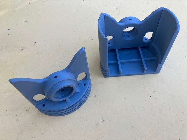

Egge pistons are often "out of stock" because they are unable to make them fast enough to keep up with demand. I have a piston design that is lighter and stronger than the Egge design. Lighter reduces connecting rod stress, and makes the engine more responsive. Stronger allows higher RPM. If we can produce pistons for a competitive price, we will offer them.
I congratulate Arnold for making a ceramic/carbon seal water pump, but I don't like that it doesn't look like original. The water pump I designed will look like an original Model A water pump, and I have sent step files to my son Jesse for 3-D printing.
The following pictures show details of the new printed piston.

Here is a 3D printed mock up piston with modern short skirt going in a Burtz Block.
This is for a Dual Overhead Cam head.
