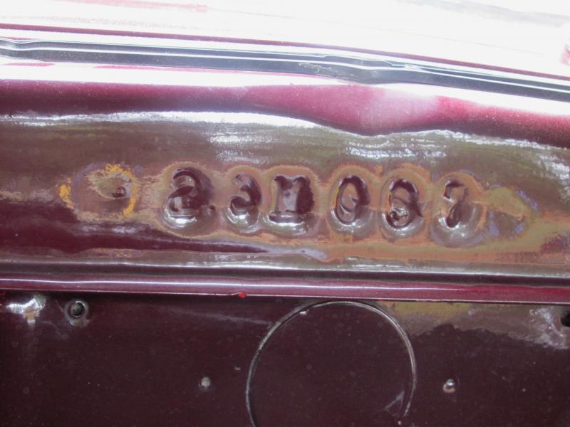

I believe the code number stamped at the top of the firewall indicates which plant manufactured the car. Attached is photo of the code number in my '47. I havent decifered the entire number but understand the last "67" means it was manufactured in June '47. The code number obviously doesnt tell what dealer it was shipped to.

Otherwise, have you talked to the previous owner ? What about web sites that claim they can track your VIN number ? (never tried them) Factory Body Code No.jpg
At some point in '46-8 production, not sure when, they put a box for assembly plant code into the little patent data plate...if you have that and if it was used, there will be a 2-letter code for the plant punched into a little box. All other info on the plate is generic and was printed on. My '48 has ED there for its Edgewater build.
