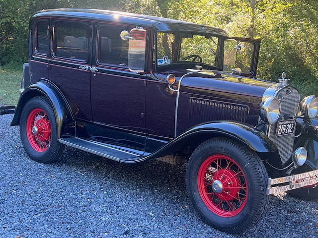

Since replacing that failed engine, my wife limits my speed to 55MPH on the highway. I travel on the interstates often cruising at 50 MPH. I leave a lot of space for modern traffic to cut in front of me. I do not compete with modern traffic in any way. Last week I ran down I-395 from Southbridge, Massachusetts to New London, Connecticut in pouring rain without any modern traffic issues.
My Model A's have 3.78 differentials & hi-compression cylinder heads.

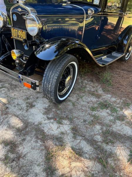

Hello unfortunate about rod throwing, I drive around 45 mph , car is stock . On past Ford Barn discussions tire size seems to be the big factor in braking , have the 19 x 4.75 radial on the 1931
