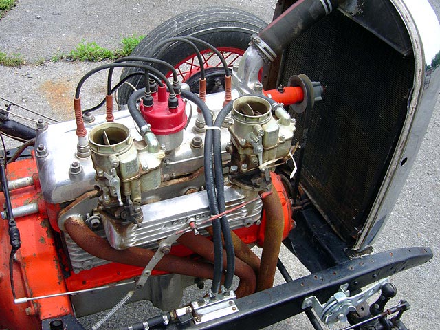

Brent, What engine mods did you make to run two 94s on your banger. I keep hearing that it's too much carb for a Model A. My motor is .060. over, "B" cam, counter balanced crank and lightened flywheel and V-8 clutch. I'm waiting to get either a Winfield 7.1 head or something similar. This motor goes in a similar speedster as yours shown.
The engine in both cars is a G28T engine with 1.750 intakes, a cam that Pete Samuelson ground and sent as a gift (-well, it was exchanged for something however we will leave that right there even though the statute of limitations has likely expired!! ;)), and a Dan Iandola head that CC-ed at about 8½:1 compression. Maybe Pete can share the specs?? The rear axle had 4:33 R&P, and no idea on what the height of the tires were.
I ran several different ignition systems during that time, and all were similar except the mags. In one of pics, you will see a Model-A distributor that had a Pertronix Ignitor set-up and whatever coil they recommended. Likely the best was with the Mallory Unilite distributor that had a Blaster Coil and a MSD 6AL box. The worst was a WICO mag, and I also had a Scintilla Vertex mag that had great crowd appeal but I wasn't a fan. The bottom line is if you can have good hot spark where you can 'light' the fuel mixture cleanly, then you can run a fat mixture successfully. If you can hide an MSD box, then you can generally run less timing and still make good power. And, ...your bearings will love you for that!! :D
