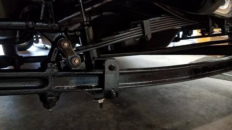

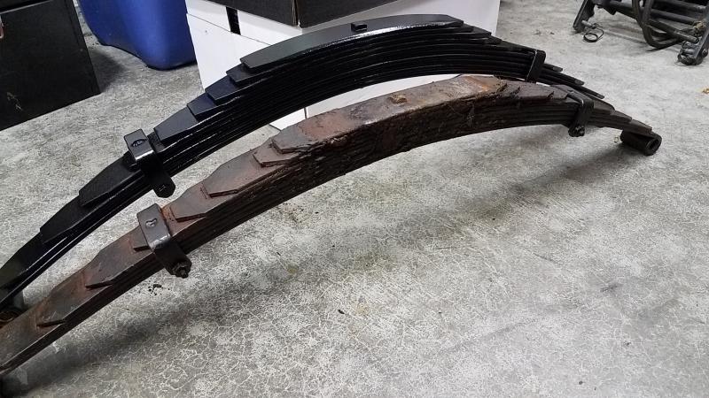

I thought I would follow up to let everyone know that I have the new spring in, new shackles and bushings, and new shocks on, and it rides MUCH better than before!! I will attach a few pictures. A few thoughts and info:
1. The old spring had 9 leaves, the new one (from Snyders) has 10. Does anyone know why the old one only had 9??
2. My car has the modern shocks - the old u-bolt on the axle on the one side had too much thread on the shock side and it bashed a hole in the shock, so one of the original shocks was completely frozen! I'm sure this contributed to the harsh ride...
3. I beefed up the shock mount clamp on the bottom. Rather than using the small cheap u-bolts, I made a plate and then used grade 8 bolts.
4. The tube shocks are Monroe #5829 - spec'd for a 1978 Plymouth Volare :). Don't ask me why but they seem to be the right size...first time I ever ordered parts for a Plymouth, LOL
Anyway, I think the project was a success. Someday when I'm rich I'll consider an original shock set up. :) Thanks again for all of your help!

Re: Front spring replacement advice - updated
2. My car has the modern shocks (originals not in the budget) - the old u-bolt on the axle on the one side had too much thread on the shock side and it bashed a hole in the shock, so one of the original shocks was completely frozen! I'm sure this contributed to the harsh ride...

Those are gas charged shocks. Glad they are working out. Are they on the rear as well?
Yes, they are gas charged since that is all I could find. I've heard that some people recommend non-gas charged, but I can't see that anyone makes or sells those anymore??
My 1930 Fordor has a extra Leif in the front spring . Maybe because it was sold where there was dirt roads
Mine has 11 leaves as well. I was told that it was done to reinforce a tired original spring. It seems to do the job - the ride is firm and the car sits at the correct height.
