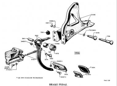

Now did you convert to front disc with the booster upgrade or did you leave the car drum/drum?
So just mounting and aligning booster on the firewall worked for you?
OH!
And how did you connect the booster push rod to the TREADLE-VAC linkage (hardware)?
Inquiring mind want to know ... :D
You're making my brain hurt trying to remember the details..:<)...the picture of the booster is what I ended up hooking to the stock linkage under the dash. I do not recall the actual fastener I used to connect the push rod to the pedal linkage. Nope, stayed with the drum/drum. The brakes were Mercury/Lincoln, 5 X 5 and self adjusting. The main issue with later boosters is the mounting bracket/spacing as best I can figure.

So the EDSEL put MERC self-adjusting drum brakes on the wagon version also, along with TREADLE-VAC?
... the picture of the booster is what I ended up hooking to the stock linkage under the dash. I do not recall the actual fastener I used to connect the push rod to the pedal linkage.
And the drums work well with the DISC/DRUM MC and PROPORTIONING VALVE? You decided not to go with a DUAL RSVR DRUM/DRUM MC at the time?
You're OK. Just wondering how you were able to do a mostly easy install without having to modify the TREADLE-VAC pedal linkage.

I found the brake shoes were Merc/Lincon when rebuilding them. The car Was a Pacer 2dr, ht. Yes, the emergency brake on the Pacer was foot operated, do not know if it was as such on the wagons....the master for the 65 Bird was a single pot, single outlet (two ports fed from the same source in the casting), the output in a Bird fed a junction block splitting the front line from the rear just like any single pot system. The rear line had the proportioning valve in it. My Edsel....

Made a bracket to mount a dual 7" booster to the original treadle-vac mount and was back in happy land. The master was a 65 Bird. The original brake assembly worked just fine.
