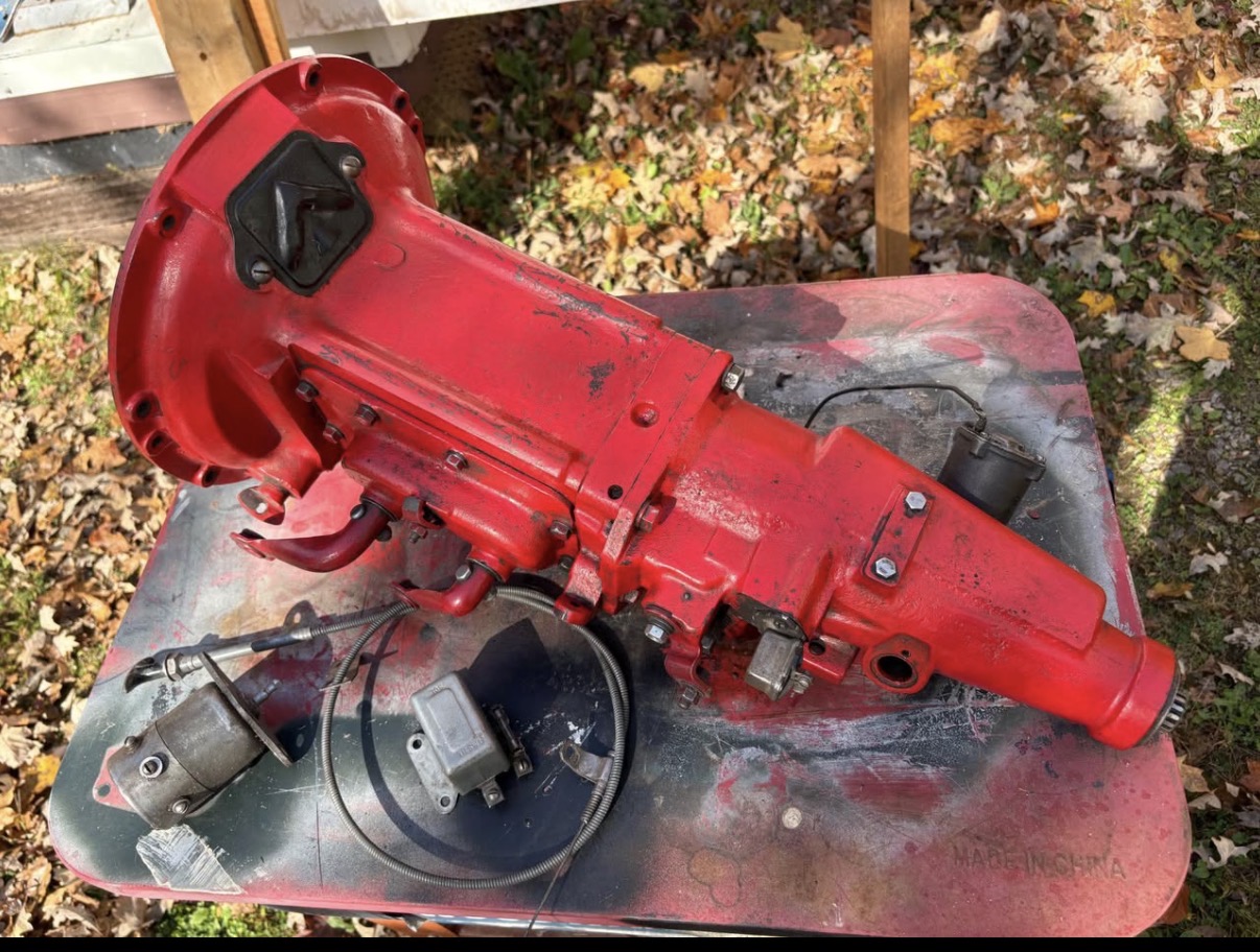

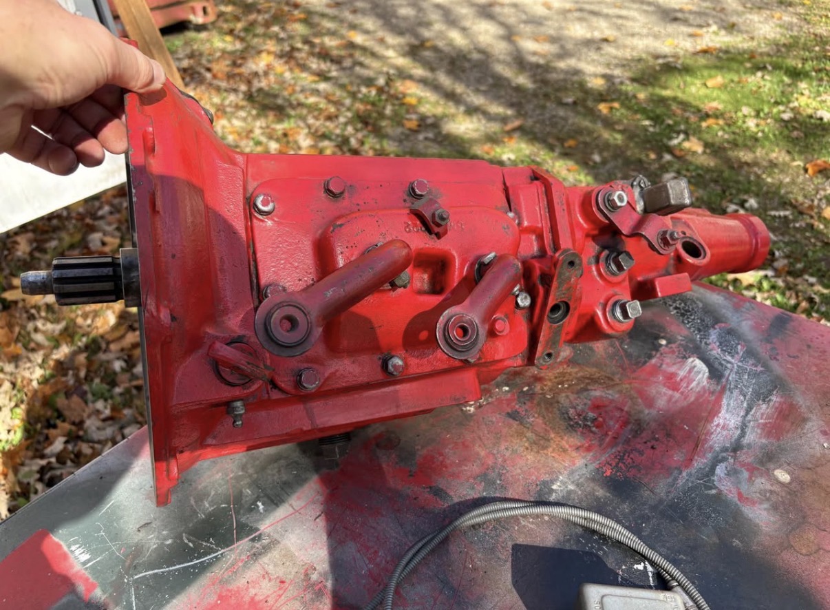

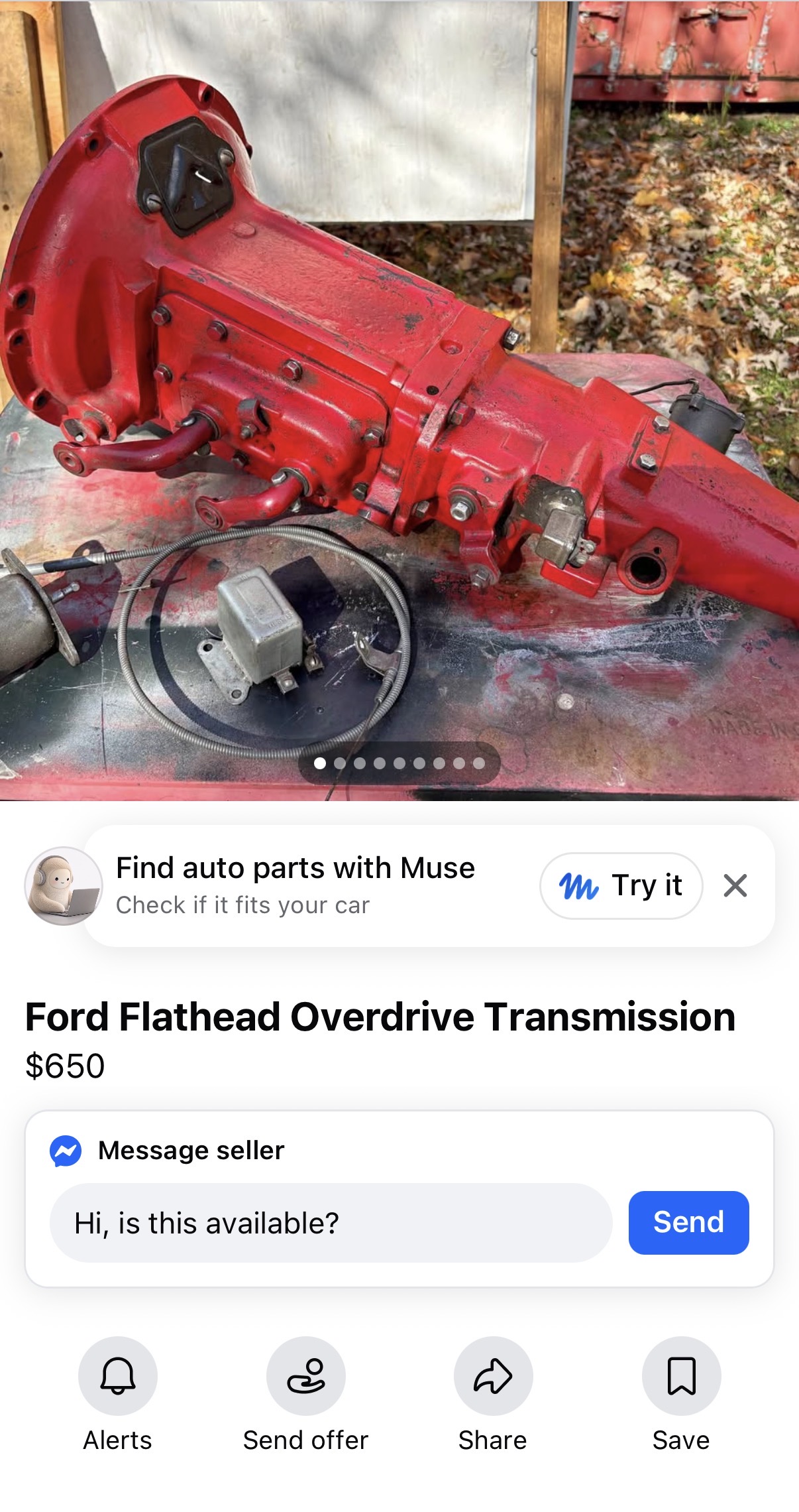

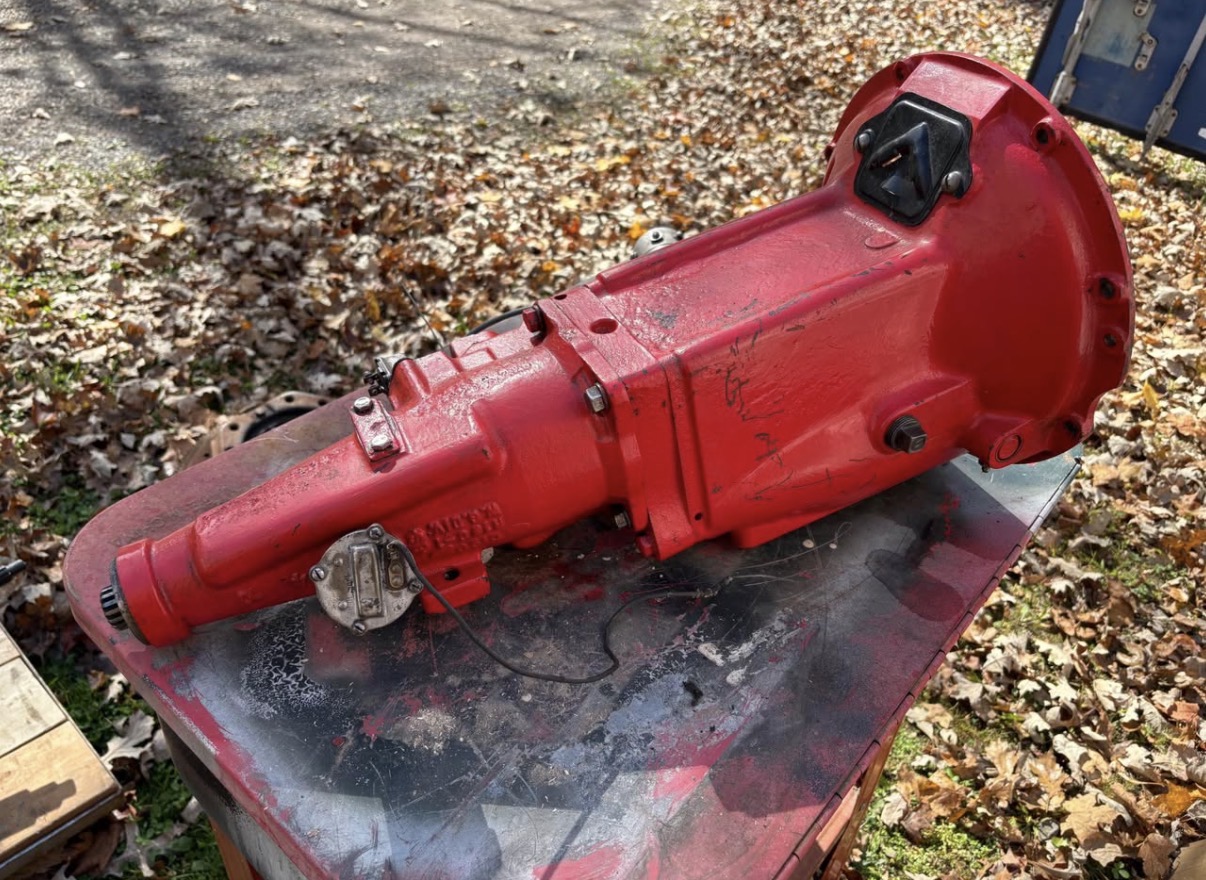

Came across this yesterday on FB. I had never heard of one before. Are they any good?

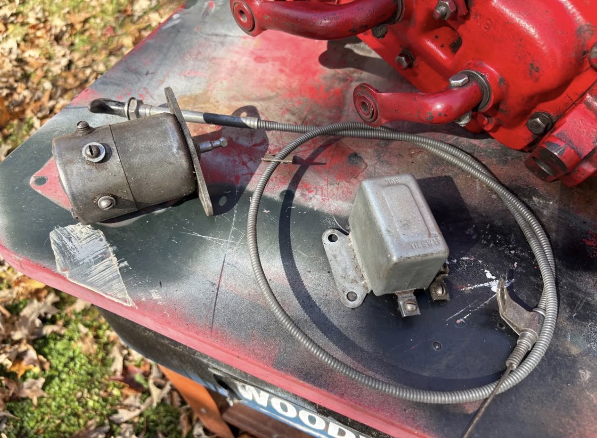

'49-early '51 Mercury with the B/W R10 overdrive. Not the strongest out there, but a very useful unit behind a flathead. Some folks "cheat" and simplify the electrical operation when installing them, but I find when installed properly (factory wiring with kickdown switch and relay) they are more functional, and less vulnerable to breakage. You might have to do a little "mixin' and matchin'" to come up with a proper clutch for the earlier engine (these Merc's used B&B pressure plates), but there has to be something that should work.

I can see just about everything you would need except the "kickdown" switch. They are readily available. Actually, most parts are because so many manufacturers used them.

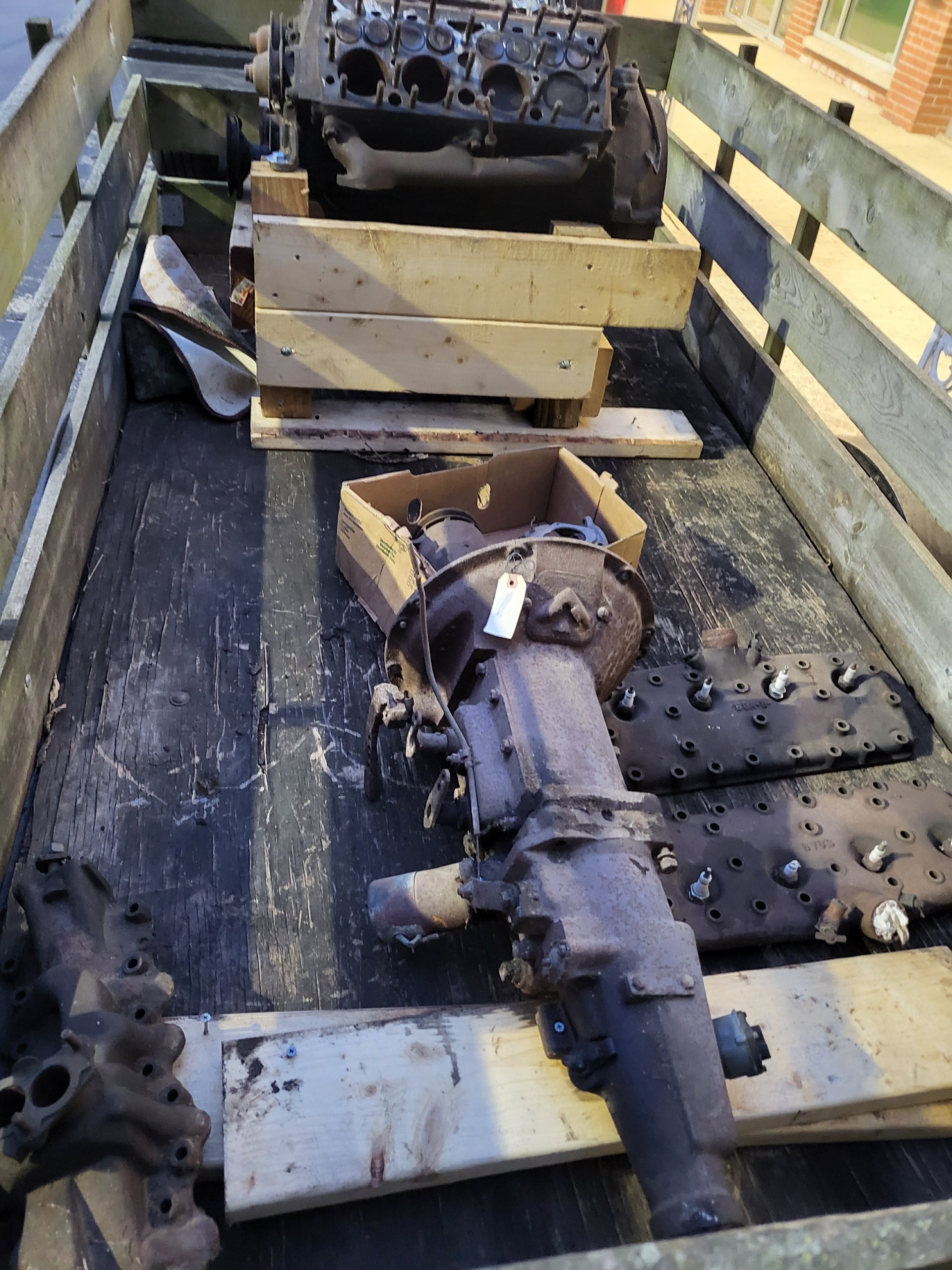

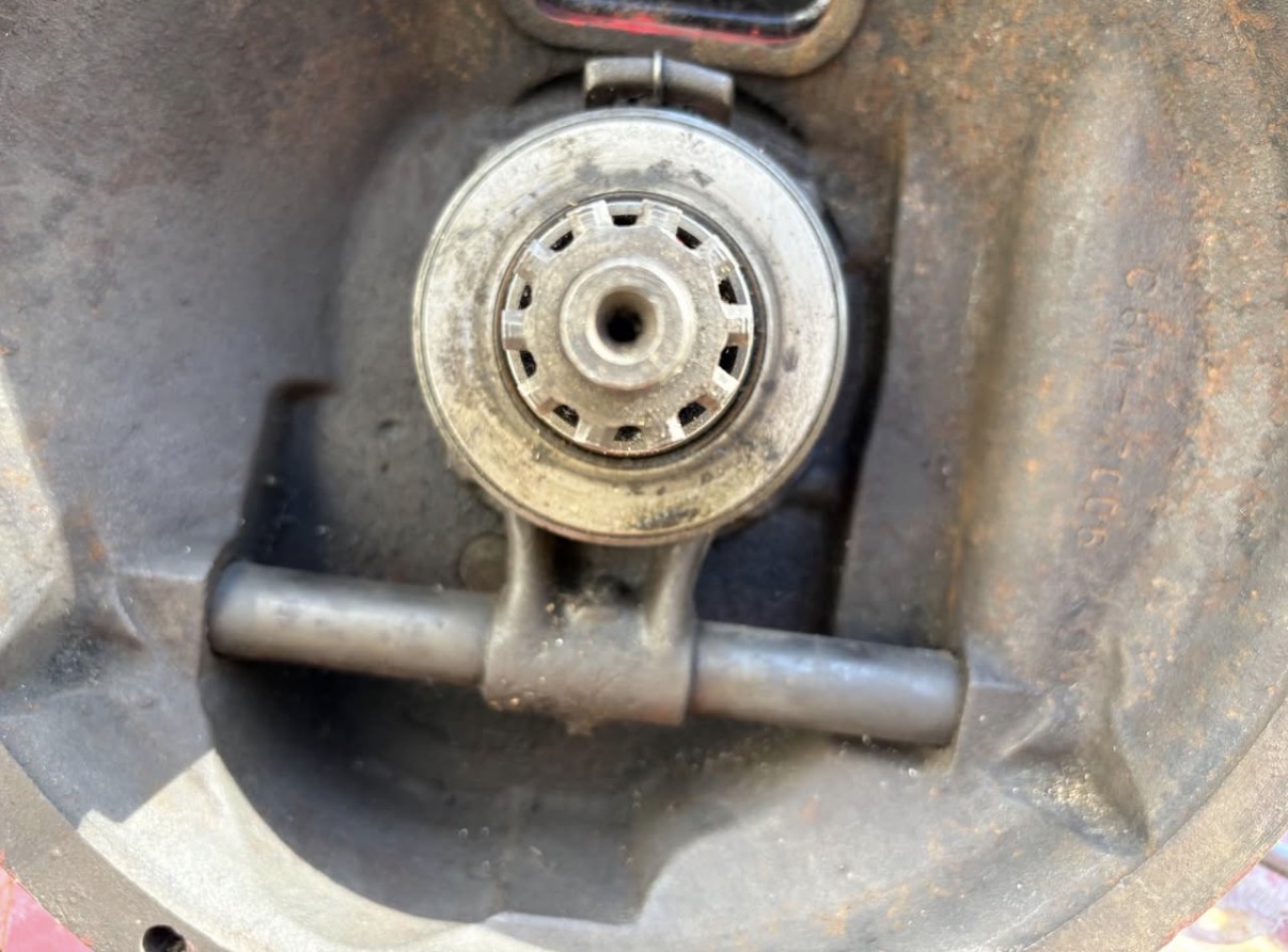

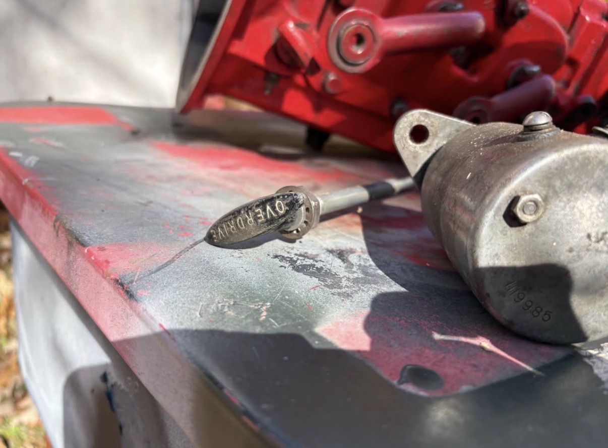

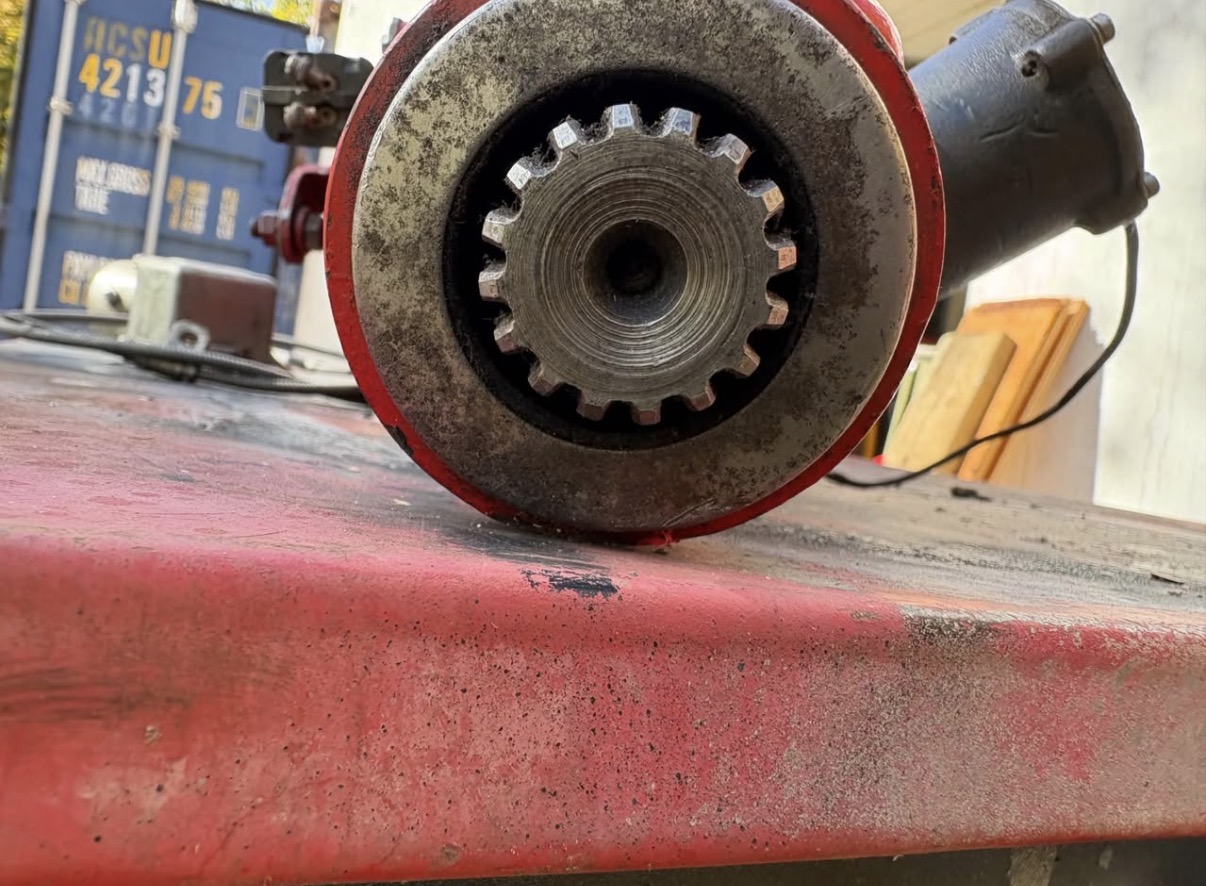

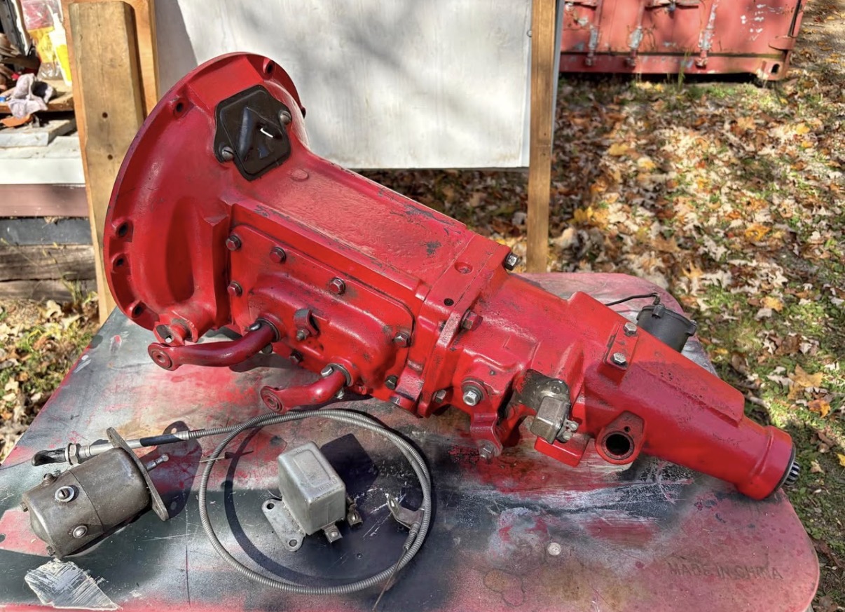

Just thought I would add this, picked up the transmission today. Had to take that engine too.. forty bucks, needed the starter and breather tube off the intake manifold.
