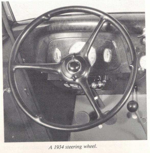

Don. you've sent me on a quest.....here is what I've found in a short period of time.

Thanx Robert, but could you please pull the mat back so that I can see the base, LOL I don't remember where I bought this but just a repop.

After googling I finally found a picture and some more info. Guess where I found it. On a site called FordBarn, LOL. I bought mine from 3rd Gen. All of the suppliers offerings look like mine and the flat side points at the accelerator pedal.
Ahhh grasshopper, I see says the blindman!!! My bad/mis-understanding
From a David Cole document for 32 floorboards.
... "And now you know the rest of the story" :-)
