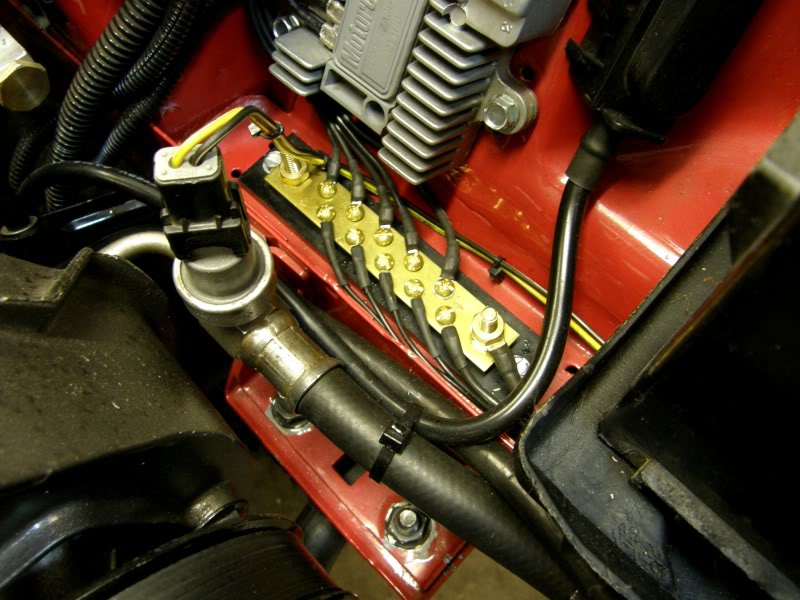

Alaska Jim has a good point. Check that out. Other than that, sure sounds like a ground issue to me. Fox body Mustangs are notorious for bad grounds. On all my builds, and especially my 2 Mustang builds, I make the entire chassis a ground plane. I weld studs to the frame and run my NEG batt cable directly to that. I run two 4ga cables from each side of the engine to welded studs on the frame. I also run a 4ga cable from the body to a welded stud on the frame. Finally, every accessory ground wire I run to a terminal strip and ground that to a welded stud on the frame. In all my builds never have I had a ground issue.
https://www.fordbarn.com/attachments/494841/
