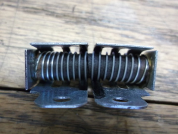

Is the part # ICR40 the correct resistor for my 34 6 volt system? While I was restoring this pickup I bought the complete resistor & fuse block from Mac's when I had the car running for the first time it was outside & I kept smelling something burning, it was the resistor it became completely charred so I put the old resistor back on. I don't want another chinese junk one so would like to get one from Napa. ( the young parts guys don't have a clue) Thanks in advance.

That resister shows its a .35 ohm
It maybe just burning off coating.
If you have ohm meter orginal was .5
if you have volt meter go across the resister running should read about 1 volt leaving 5 volts to coil.
With .5 would be 1.5 volts

Thanks for your response, any & all info is appreciated. If you look closely you will see that the core on this resistor is burnt in half I don't know what the material is but it sure isn't ceramic like the original. Thanks again.
