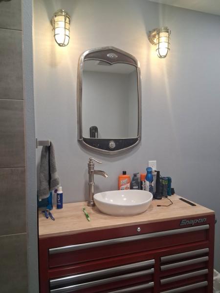

How about making some bathroom mirror frames:
588451
....or like this one with LED lighting around the inside:
588450

OMG, can't imagine what my wife would think when she walks into the bathroom and sees another A part in the house. OUCH!
