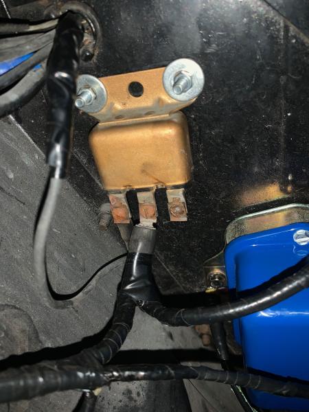

Hi Everyone,
Hopefully this is a simple one. When my steering wheel is assembled (horn ring), the horn is on, regardless of pressing the ring. At the moment i've disconnected the third terminal of the horn relay to stop myself from going crazy. Pictures are attached, am I missing a piece of the horn ring that prevents it from being grounded out immediately, or is my spring bad?
Also, ignore the electrical tape, new wiring harness is being ordered :)

Disconnect the horn wire where it comes out of the bottom of the steering gear box and reconnect the relay. If the horn doesn't blow with the horn button wire disconnected repair or replace the horn button wire. If the horn blows with the horn button wire disconnected either the relay is stuck or the wire between the relay and the horn button wire is grounding on something. If the wiring is original the problem is probably in the wiring. The original wiring insulation is rubber under a shellacked cloth loom. Over decades the insulation deteriorates, creating bare spots where the conductors can ground on vehicle parts. Attempting repairs is pretty useless because while you're repairing one bare spot you're creating others. Fortunately you're only dealing with a ground circuit so not much chance of a fire. Also check the horn button insulator pad under the steering wheel. They're just foam rubber and crumble after several decades.

Constant horn blowing usually means that your horn button wire insulation inside the steering tube has worn off and is now in contact with ground (which completes the circuit, the same as if you pushed down on the horn ring).
Take note that there should be three wires going to the horn relay. The middle terminal gets the yellow wire (that is the power wire to the relay coil). The right side terminal should have a blue-yellow wire (that is an extension of your horn button wire which is ground and it completes the circuit, activating the coil). That middle terminal is internally jumpered to the relay contact input terminal. The left terminal of the relay is the relay contact output terminal. That wire goes to your horns.
Check all your wiring connections to the relay to see if they are connected correctly. Doesn't look like it to me.
